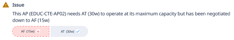

PoE stability anomalies are related to sudden changes in power draw. Data is presented over a 48-hour period, and includes date and time details. When an AP negotiates down to AF, even though it requires AT or a higher level for optimal performance and full capacity, CoPilot reports a PoE anomaly.

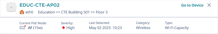

To open the PoE Stability Anomaly panel, select a location (site), for which anomalies have been detected, from the table. To view more information about an anomaly, select the corresponding down arrow. The PoE Stability Anomaly panel includes the following information:
The Current PoE Mode shows whether the affected device is online and the current power mode—AF, AT or BT. If the AP is offline, the status is Disconnected.
To get more information about the device, select Go to Device.
This section provides a description of the problem, including the actual PoE mode and the desired PoE mode.
This section provides steps to resolve the anomaly, for example:

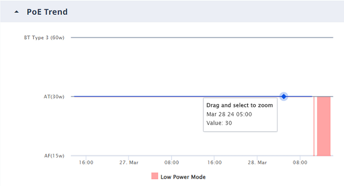

The PoE Trend graph shows the pattern of changes in PoE mode for the 48 hours prior to the last detected timestamp. To view the graph, select the down arrow.
The graph indicates the three power modes: AF, AT and BT Type 3. Red indicates a low power mode.
Select and drag across the timeline to zoom in on a section. Select Reset zoom to return to view the entire timeline.

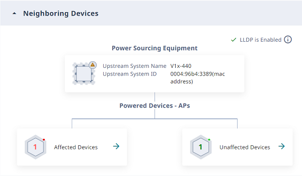

If LLDP is enabled and the upstream device is an Extreme switch managed by the current VIQ, the Upstream System Name value appears as a link that opens the D360 page for the switch.
Select Affected Devices to view a list of devices affected by the anomaly. ExtremeCloud IQ icons indicate whether the affected device is the current access point, or a neighboring access point.
Select Unaffected Devices to view a list of devices not affected by the anomaly.
The device lists include the following details when LLDP is enabled:
If LLDP is not enabled, ExtremeCloud IQ reports the affected building and the floor, the number of devices affected by the anomaly, and the number of devices not affected.
